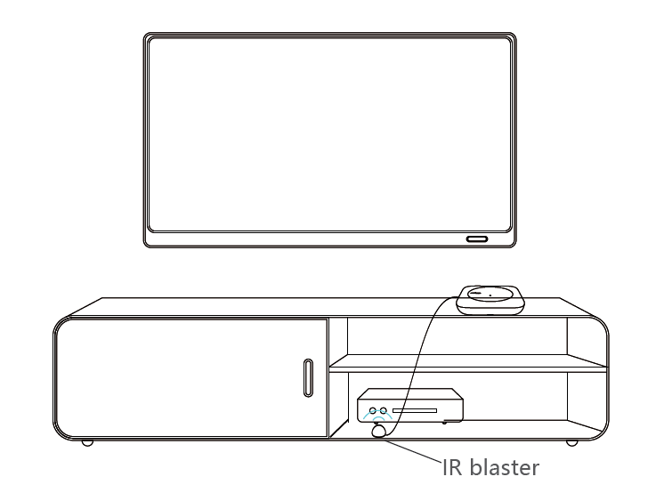

1. Hub Placement in an Open Location (Recommended)
This setup provides the best performance for the Hub’s powerful,multi-directional lR signals.
  • Placement:
Position the X2-Hub on top of your cabinet or on a large, openshelf, ensuring it is unobstructed.
  • Controlling Hidden Devices:
To control devices that are inside a cabinet, box, or behind adoor, connect the included wired IR blaster. Aim its emitterhead directly at each device’s IR sensor.

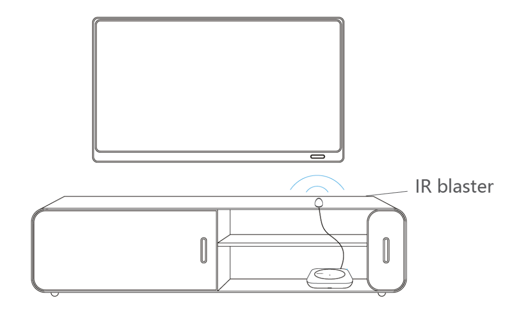

2. Hub Placement Inside an Enclosure
When placing the Hub inside a cabinet or other enclosure:
  • For devices also inside the enclosure:
The Hub can typically control these directly with its own powerful IR signal.
  • For devices outside the enclosure:
You must use the included IR blaster. Run the blaster’s cable outside and aim the emitter head at each external device (e.g., your TV, soundbar).
