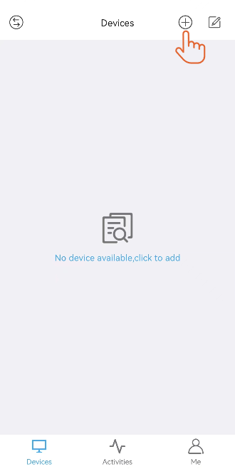

Once your Hub is connected, launch the app on your device, and it will automatically connect to the most recently connected Hub.
Navigate to the “Devices” page, and click the “+” icon in the upper right corner to add a new device.
There are three options for adding devices: Infrared Control, Bluetooth, and Wi-Fi.
If you are unsure about the control technology of your device, please consult the article I‘m not sure which type to choose.
Next, follow the instructions on the app page to complete the subsequent settings. You can select the actual device type to view detailed instructions.
