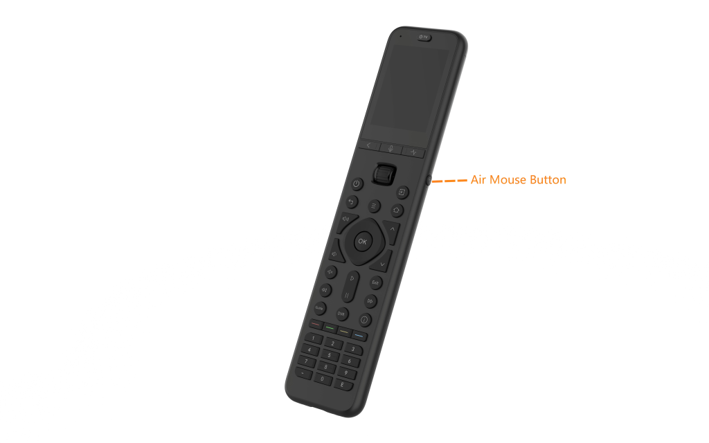

1. Air Mouse Function
The Air Mouse feature acts as a wireless Bluetooth mouse for navigating apps on supported Bluetooth devices.
1) Select Device: Use the scroll wheel to select the connected Bluetooth device.
2)  Activate: Aim the remote at the TV and press the Air Mouse button on the right side of the remote. An arrow cursor will appear on the screen.
3)  Navigate: Move the remote in the air to control the cursor.
  Note:
        Performance depends on the target device. Some Bluetooth hardware may not support external mouse input, rendering the Air Mouse function inactive.
  Calibration & Troubleshooting:
  • Alignment: Point the remote at the screen center when activating. If the cursor is misaligned, toggle the Air Mouse off and on while aiming at the screen.
  • Recalibration: If the cursor drifts or behaves erratically, place the remote on a flat table for 6 seconds to reset the sensors.
  • Signal Interference: Keep other Bluetooth devices away to avoid interference, which may cause lag or jittery cursor movement.

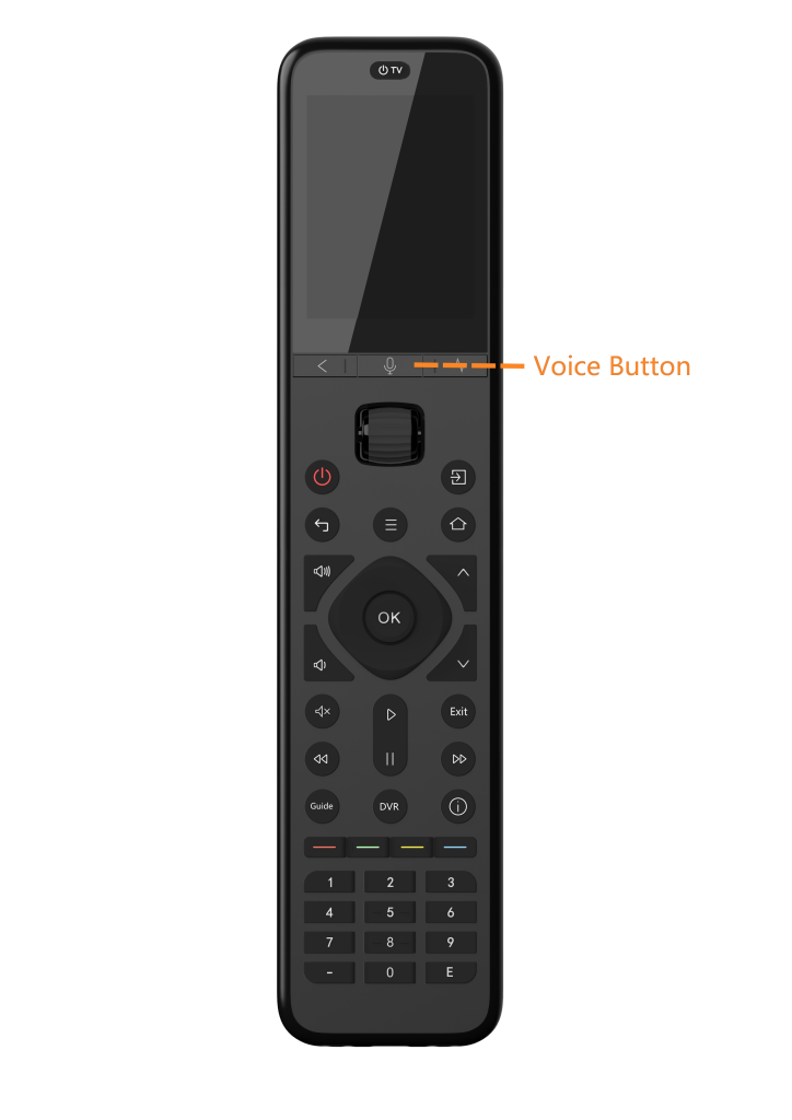

2. Google Assistant Function
1) Select Device: Use the scroll wheel to select the connected Bluetooth device on the remote’s screen.
2) Speak: Press and hold the Voice Button (located below the screen) and speak your command clearly.
Note:
This feature only works with devices that natively support Google Assistant via Bluetooth. It is not compatible with Apple TV (Siri), Fire TV (Alexa), or non-Bluetooth infrared devices.
