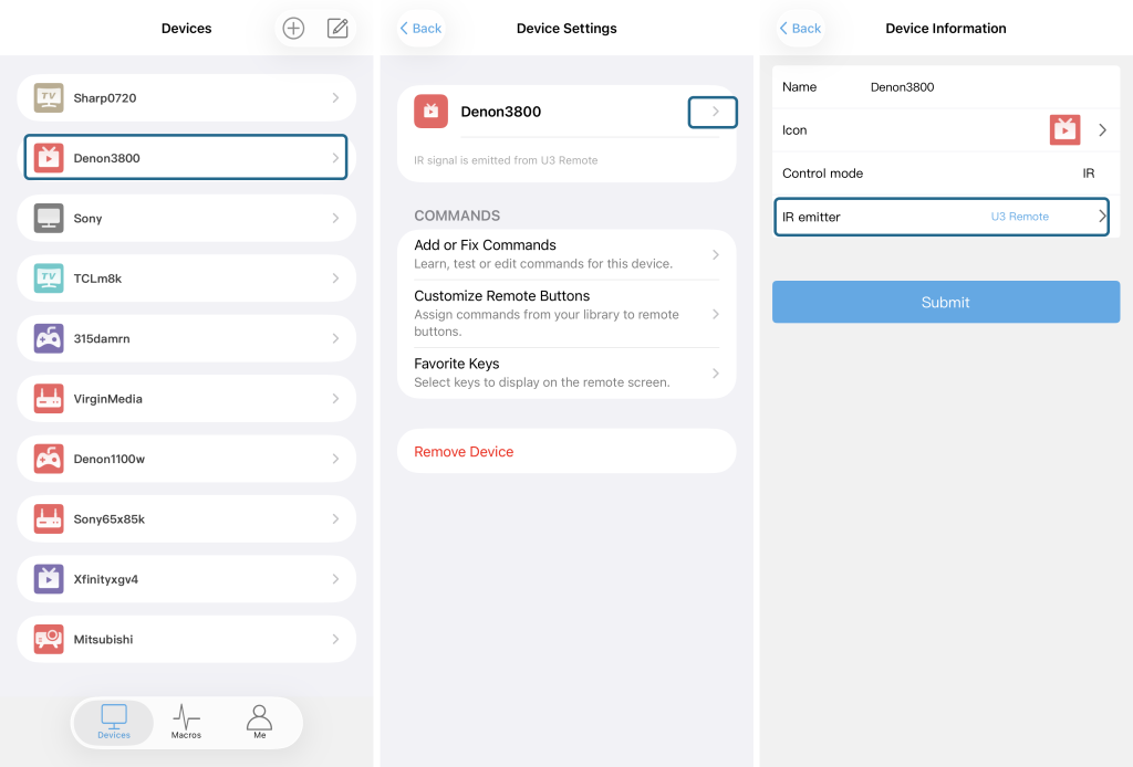

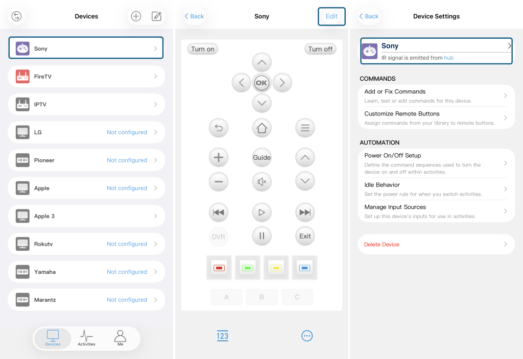

  1. On the Devices page, select the device you want to modify.
  2. Tap the Edit icon (top‑right corner) to enter the device settings.
  3. Tap the circled area shown in the screenshot to access the IR emitter settings.

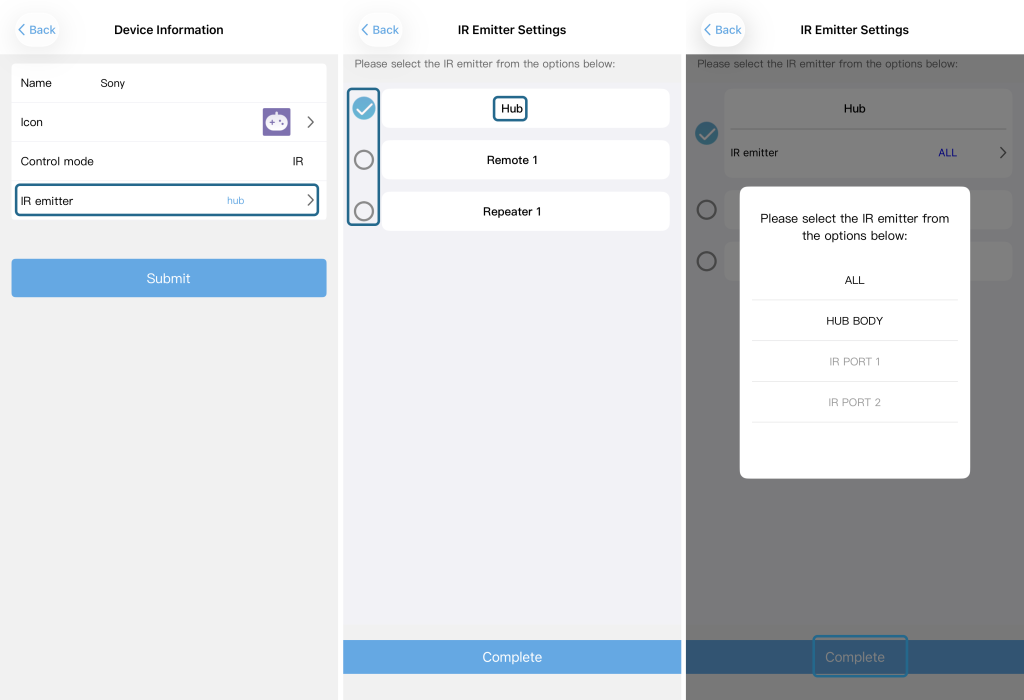

  4. Tap the “IR emitter” field. A list will appear showing:
    • The Hub itself,
    • Any Remote you have paired,

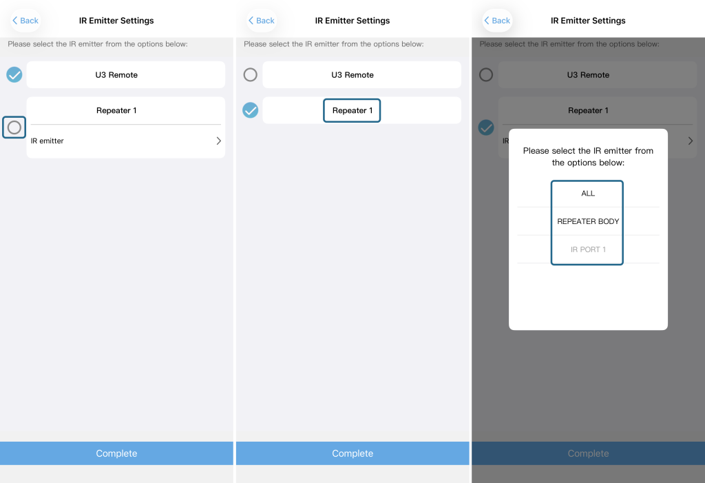

    • The R1 Repeater (if paired).
  5. Select the desired emitter from the list (e.g., Hub, a specific Remote, or the R1 Repeater).
  6. If the selected device has IR Blaster ports (e.g., Hub or R1 Repeater), tap on its name again to reveal additional port options – choose the one that fits your setup. (For paired Remotes without extra ports, this step may not appear.)
  7. Tap “Complete” at the bottom to save your changes.
