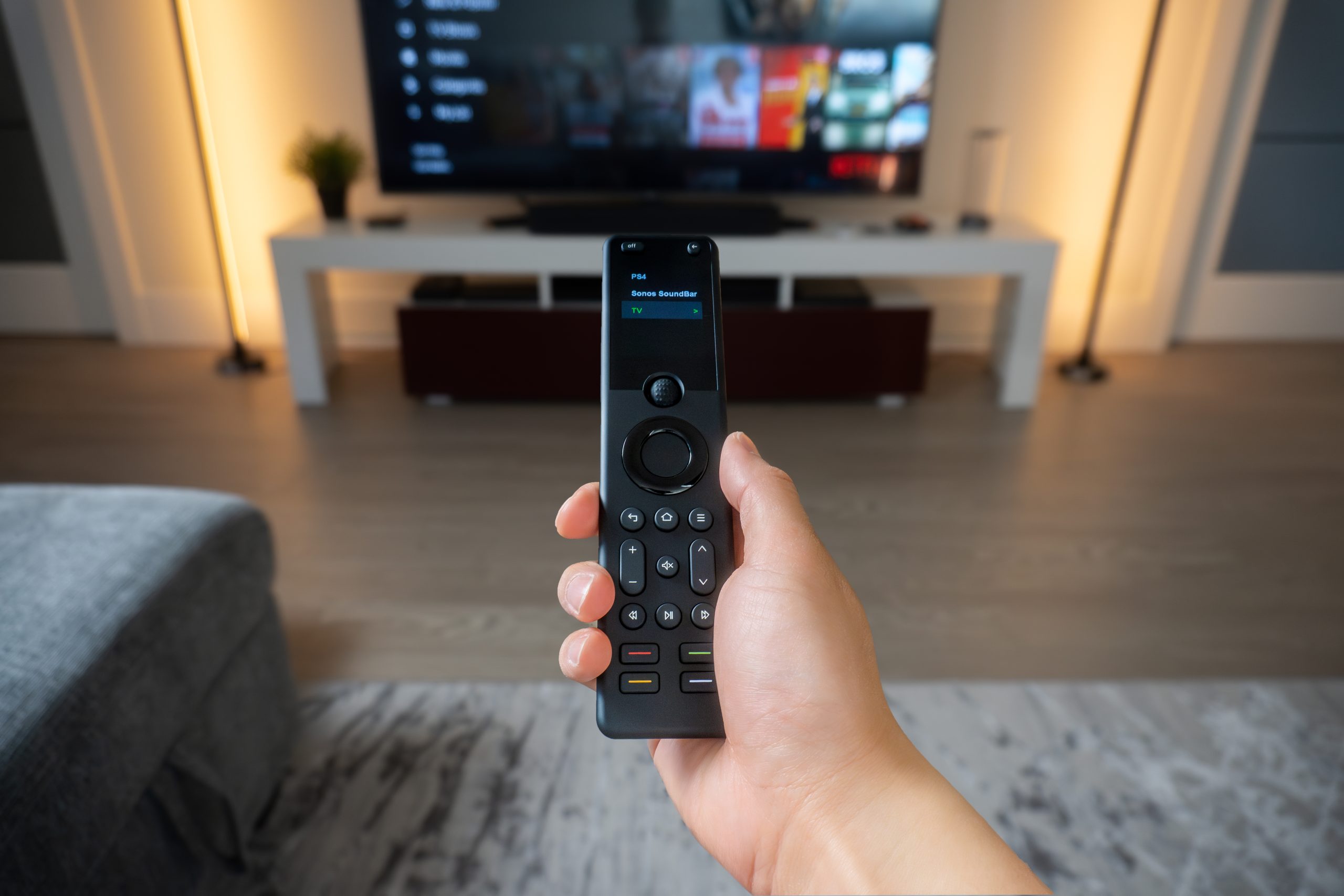

Hand using a SofaBaton X1S remote to select a TV, Sonos soundbar, or PS4.
Most replacement remotes are made for one TV brand or model family. They can send power, input, channel, and menu commands to the TV. A soundbar uses its own command set. The volume buttons will work only if the remote controls the soundbar directly or the TV passes commands through HDMI-CEC.

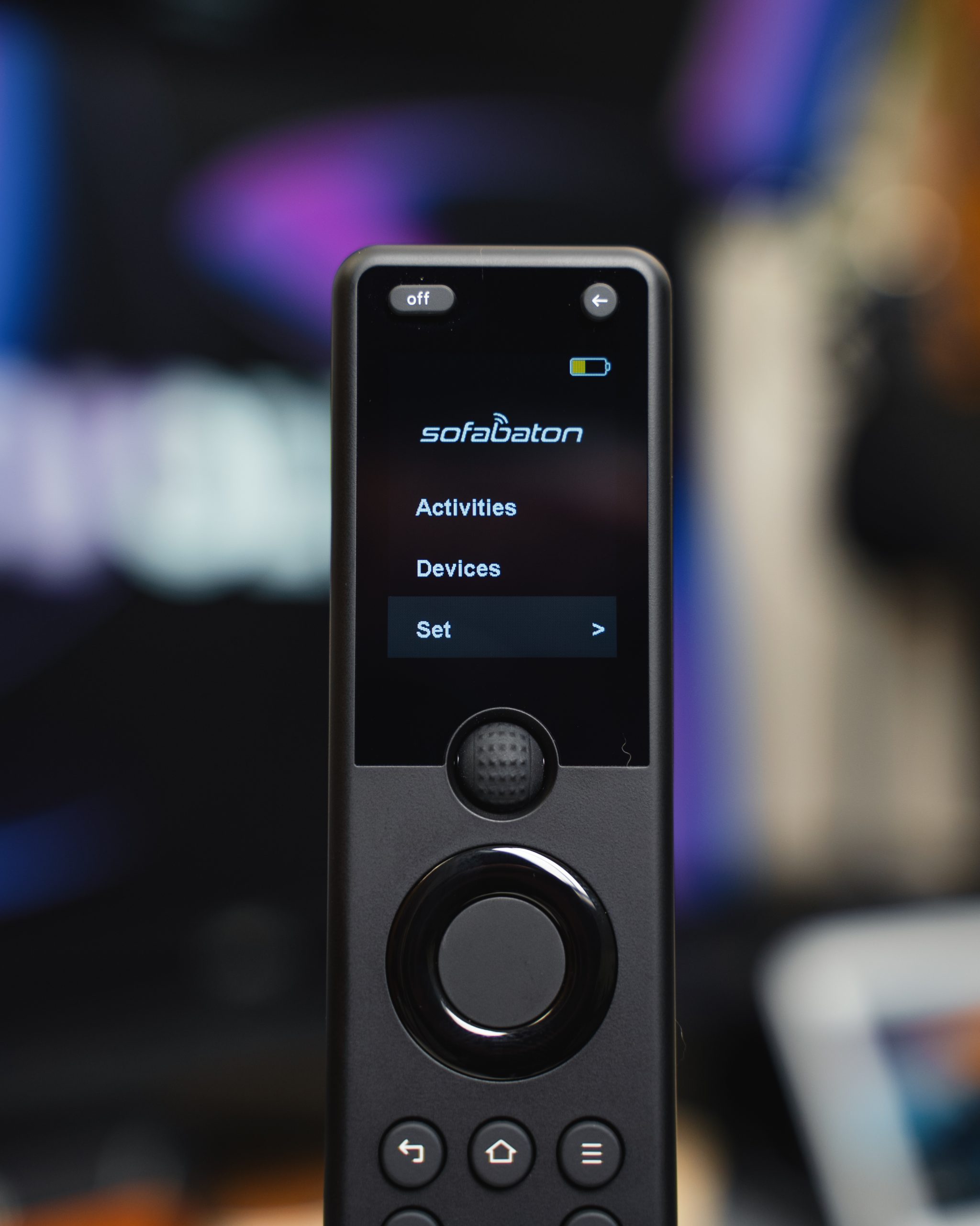

Close-up of a SofaBaton X1S remote showing the Activities and Devices menus.
Consider SofaBaton X1S when you need more than a replacement for one handset. It is designed for hub-based control, one-touch activities, repeated input changes, and compatible equipment inside a cabinet. It can send picture and input commands to the TV. It can also send volume commands to the audio system and navigation commands to the streaming player.
That is the main difference between X1S and a basic replacement remote. The X1S Hub can run activities and send custom commands. Its IR blasters can reach compatible equipment in cabinets or other hard-to-reach places. This is useful when several devices need different commands during one activity.
Compatibility depends on your exact models and control protocols. IR devices are often easier to set up. Bluetooth and Wi-Fi support depends on the device type and integration. Check each TV, soundbar, and streaming player by model number before you buy. Do not assume that every Wi-Fi or RF device will work.
